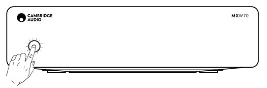

Note:  Please ensure that the MXW70 is in standby, which is indicated by only the standby LED being dim  .
Press and hold the Standby button for 5 seconds.
Will blink alternately red-white LED for five times and then go back to the standby state
